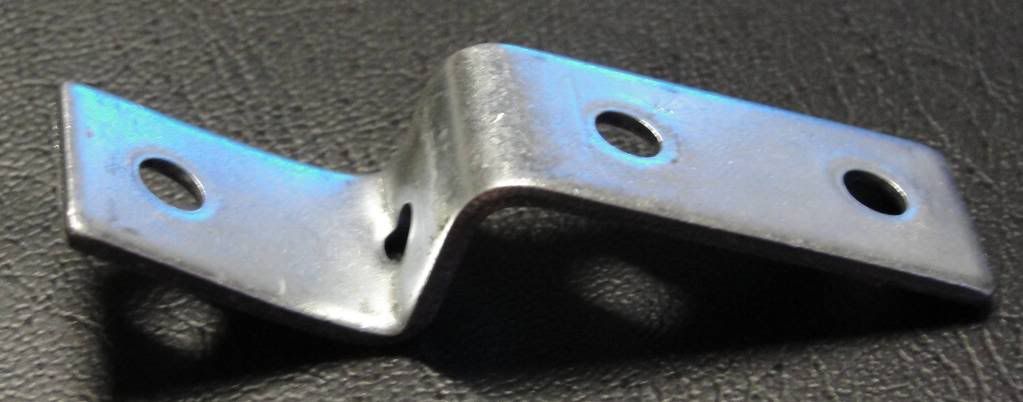

  2. Put the 2 u bolts with threads going down on the cross member in front of the rear tire. Snug up the cross plates that come with the U bolts. Leave about a 1/4 from the bottom of the cross member. ( picture 2 &nbsp
  3. The kit comes with 2 options to mount the servo, an L shaped bracket and a black bracket. Get the L shaped bracket and mount the straight side toward the side of the module with the wires coming out.
    ( picture 3 &nbsp
