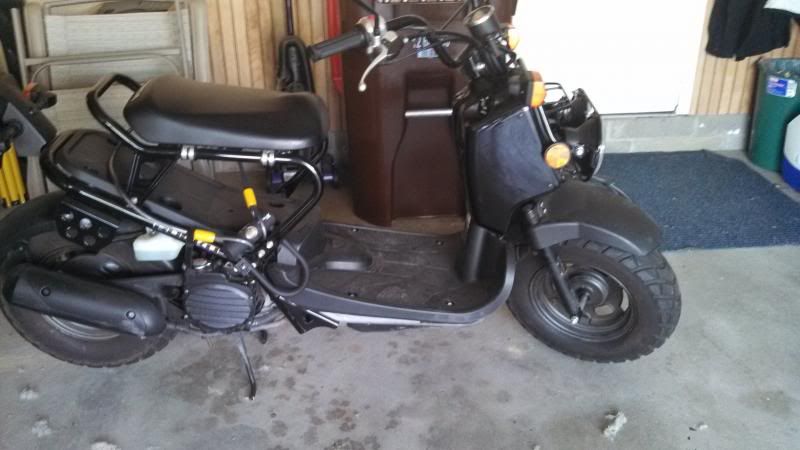

Posting this to Craigslist for a buddy, but thought I would throw it out here first. It is a 2007 Honda Ruckus with 770 miles. I tuned it up for him last year, and he said it has been running great! neat little scooter. runs about 35-40mph. Good for around town, campgrounds, cabins, etc. Retails for $1425 with more mileage. $1200 for MN X members. :D I will be listing it on craigslist for $1500. He used to put it under the coach buses he drove so he would have a means to get around at night. It is located in Hastings and you can talk to me about setting up a time to check it out. It is licensed as a motorcycle, because the state won't license any scooter that goes over 29mph as a moped :\ So you do need an endorsement to ride it
