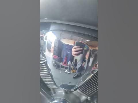

Well, I didn't get the pictures uploaded from my phone before it died, but I can share this
I call it an 1800RC as it is an R with C fenders. I do have a matching tank, I'm just running this one until I finish using the gas in it. This was taken earlier this afternoon when I was warming it up to mess with the idle air screw. The exhaust is some off brand, I couldn't find any markings on them. I didn't blip the throttle because I like my neighbors, those pipes are LOUD. I got close to the cylinders to listen to them and record the sounds. Does anyone hear anything off? I'm used to hearing some noise and tapping and such from older car motors, but I don't have a frame of reference for this one.
908 Posts
the engine sounds exactly like mine. the blowback in the exhaust doesn't sound right. obviously there's no crossover in that one and the top looks to be pretty short. it could be a back pressure issue being those are off brand straight pipes. i assume while you were in there you checked valve clearances. i can't remember if the vtx has hydraulic adjusters or not.
Sounds normal like mine:
