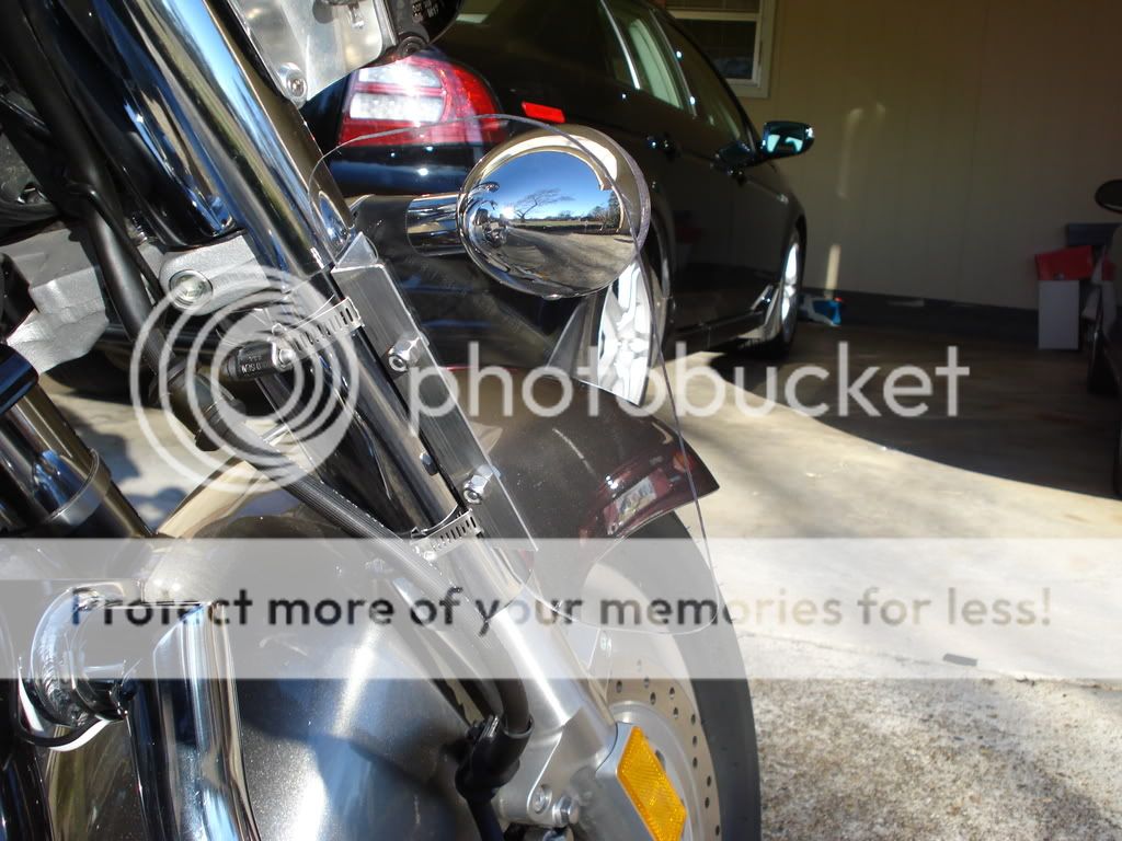

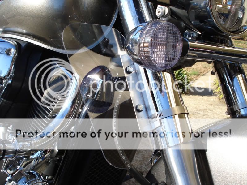

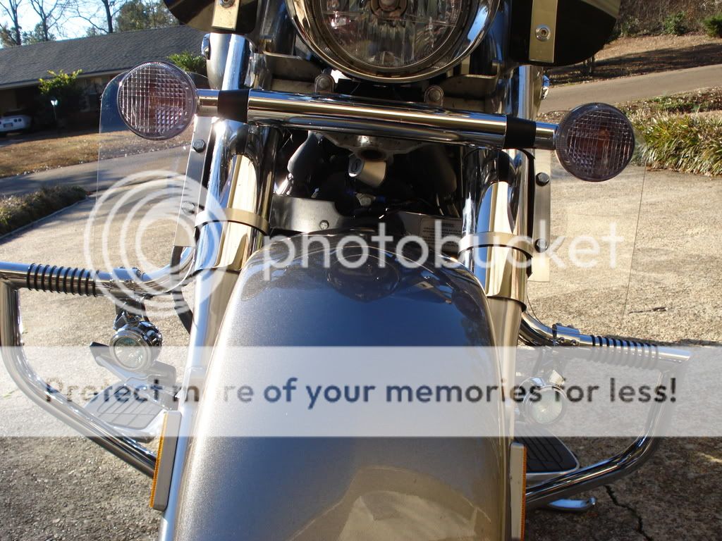

After searching and researching all over this board, I took some ideas and made me some lowers. I need to get the edges beveled, but I'm pretty pleased with them. I can't believe how much difference it made in the buffeting I was experiencing. There's still some breeze, of course, but my head no longer feels like it's in a popcorn machine.

Materials (all from Lowes):
2 sheets of 10" X 10" Lexan
4 #40 stainless steel hose clamps
4 1/4" X 1/2" long stainless steel hex bolts and lock washers
4 rubber washers
3 ft long piece of angle aluminum
scrap rubber to use behind clamps
I drew out my design on a piece of paper and then traced it on the Lexan. I used a jigsaw to cut it. I cut two 6" pieces of aluminum with a hacksaw and drilled 1/4" holes in it for the bolts. I also used a Dremel tool to cut small grooves in the angle of the aluminum pieces for the clamps to go through. I used a 1/4" glass cutting drill bit to cut holes in the Lexan, but a regular bit may work just as well. I didn't want to chance cracking it. I attached the lowers to the angle aluminum and the glued a strip of rubber to the part of the aluminum that rests against the forks. I glued small strips of rubber to the inside of the clamps and then attached the lowers to the forks using the clamps.

You did a really good job hiding the rubber under the clamps. I was gonna suggest that until I read your second post. You can't even tell it's there in the pics. Good job!
