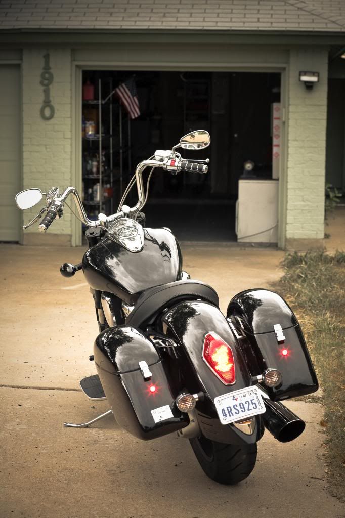

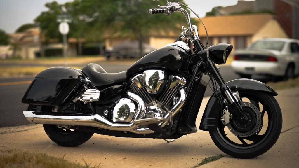

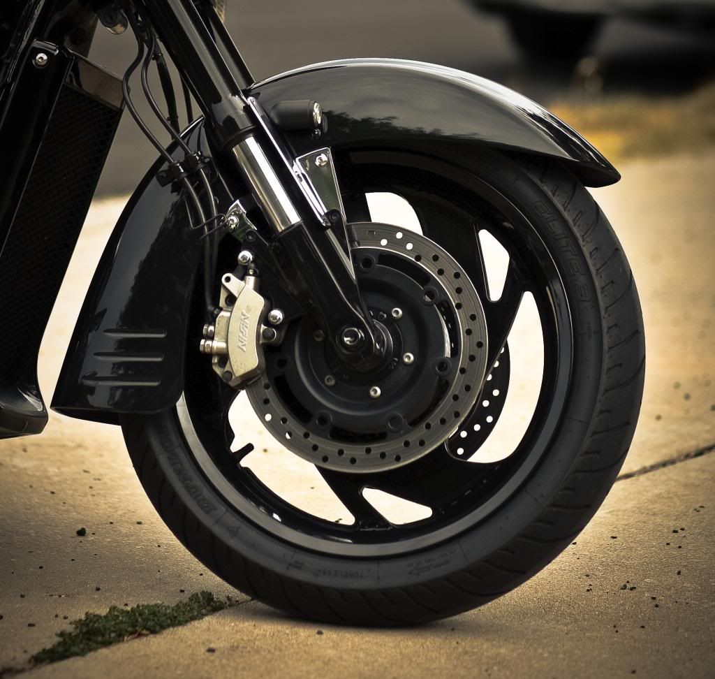

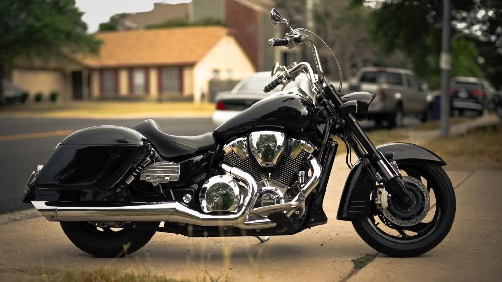

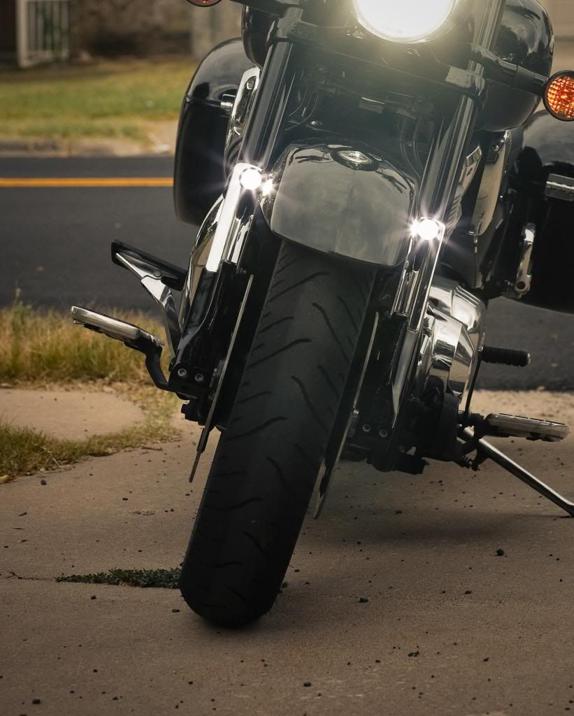

It's been awhile since I have posted and wanted to share some progress on my scooter. I switched the front wheel out for a 1800C wheel, painted both wheels black, blacked out front end and installed some Cree LED running lamps. The front are 9w and the rear are 7w, they are super bright and can easily be seen in the day time.

Very nice, I like the whole black and chrome look. Just an FYI, Metz and a couple other manufacturers make a 140/18 that fills the fender a little more if you're interested. It's a bias but I have 2 customers running them with radial in the rear with zero issues :doorag:

Thanks Jon for the info on the tire, I think the R is a 150 in the front and I never liked how fat it felt at slow speeds. My first VTX was the 1800C and I loved how it handled in corners and parking lots/slow speed. I really like the new Elite 3 tires, I had one before but never both together, they are super sweet and very aggressive grip. [HR][/HR]Yaesu, the Cree LEDs for the front: http://www.ebay.com/itm/Motorcycle-...Parts_Accessories&hash=item35cb84079b&vxp=mtr and the ones in the back are red eagle eyes on ebay for $8, use resistors or the 12v will blow them out in a week (something like these):http://www.ebay.com/itm/RED-UNIVERS...Parts_Accessories&hash=item19d7516a9c&vxp=mtr
16,084 Posts
Yes Adam, the R is a 150/17 on a 3.5 inch wheel and the C is a 130/18 on a 3.5 wheel. I think the 140 handles the best of the 3. The 150 for sure is a slow turner and a real parking lot hog. In the end it's what you like best that is important :thumbup: Here is a pic of mine with new blacked out side covers. I don't have a full size shot but you get the idea. The balck out look is pretty cool IMO compared to some of the overdone chrome whores out there :lol:
